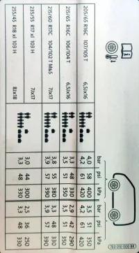

I stand corrected. There is very little difference with a 255-45.
I've got 255-45-19 tyres, so assumed they'd be too small on an 18. On a side note, although my tyres are larger than the standard ones, the vans speedo now reads spot on with GPS. I know it's better to have an over reading speedo to give a little margin, but has anyone considered that the van is recording more miles than it's actually doing with smaller tyres.
I think that is the 'correct' size as specified by VW. But, it is also 0.5% smaller than the stock 17" (215/60/r17).
It'll work really well but 'aesthetically' it might not suit what people are after (fills the arches even less than the stock 17" wheels).
That said, if lowered and with the offset adjusted, I think they look pretty good. The one in your pictures certainly looks decent.
