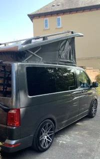

been sitting on the sidelines since getting my T6 at beginning of December last year, I'm converting it to a "Flexi day van" living in Cornwall I didn't want to go too low, so here it is 18" Zito's ET35 with 255x45 R18 with a 50mm Drop on H&R springs, very pleased with the comfort an quality go the ride.
Got the wheels on last night just as it was going dark. Photos from this morning after snow overnight. I’m well pleased with the Bronze against the Indium Grey.
They are 19x8.5 1Form EDT.1 with 245/45/19 Goodyear Vector 4Season Gen3 SUV tyres.
Many thanks to Oli @BognorMotors for sorting the rims out. Now just to get the STX fully lowered on my next trip to Bognor.
