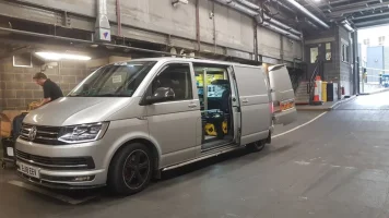

Not quite Wednesday but been meaning to take a photo for a while! Full custom Sortimo racking kit, couldn’t fault it with my last caddy maxi.
Just in from wiring up some extra lights now that the nights are drawing in again.

I just dealt with the local rep for my area. Took a bit of time mind you to sort out the design and layout to what I wanted. Too much choice!
Last lot I had fitted by Vanax in Glasgow. It had a full false floor with drawers, then the modules on top of that.
This one all came pre-assembled from Germany. It was just a case of setting in the floor, marking where you wanted the unit and then fitting big T-nut in the floor. Before bolting it all in place and bending up the brackets.
I made it myself. All the frame I bought online from KJN Aluminium Profiles. You can get it cut to size, then with a little bit of drilling it mostly just self-taps together. The drawer hinges I got from GSF Promounts - they do all the gear for fire and emergency vehicles. Not cheap, but I’ll be able to take it out and use in future vans.
