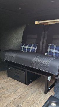

Anyone have a recommendation on a draw fridge?
I like the idea of the Vitrifrigo 30L as it has a freezer, and night time function.
Others are Alpicool 30L (nice price on this)
Dometco 30L
Waeco 30L
It will be going under a full width Rib seat.
Im guessing power consumption is also a consideration.
Any thoughts, things to look out for etc?
I'm going to fit a drawer fridge under my RIB bed so can anyone recommend one?
There seems to be a big difference in price from £700+ for a Waeco to around £300. Is it worth spending the extra?

I'm running a Alpicool under my 150 rib.
Fits perfectly in the middle compartment of the 150. Currently around 15 months old and still perfect.
