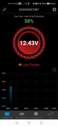

I have a BM2 battery monitor on the battery, I'll try and attach the screenshots to see if it's draining too much still or is it normal now??? Cheers all.
Last night...
This morning...

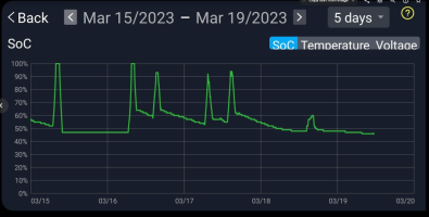

eg from my BM6 monitor:
and a 5 day plot of SOC:

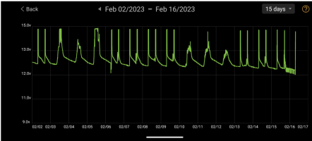

and an example 15 voltage plot:

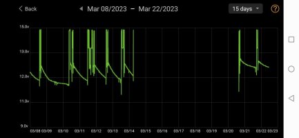

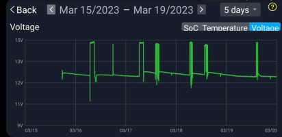

This is an older 15 day voltage plot mate...
And the latest...
I was away till the 19th so she was parked up in an airport car park. When we got back there wasn't enough in her to start. Which I already new it wouldn't, so I had the NOCO on hand. I had the auto leccy guy out then on the Monday the way 20th, and he thinks we've sorted it (he's said that before though).

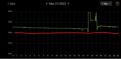

Last 7 day plot...
And last day...
Cheers @Dellmassive as usual would've been nacad if it wasn't for yours and the other guys on the forum help and advice!
This was yesterday's full day...
I think it's definitely better if not sorted. I have a new larger battery ready to put in her but don't want it in till I've sorted the drain. I'll always have slightly more than an average T6 because of the adaptions I have, hence why I'm putting the better starter battery in!
its looking much better. . .
the starter battery should stay above 12.00v for at least 3 weeks, possibly longer.
you previous plots show an issue with the starter battery dropping bellow 12.0v fairly quickly.
BUT NOW STAYING WELL ABOVE 12.0V - SO much better.
yesterdays full plot shows the marked improvement. . .
now keep using the van . .
then post a 7 day, then a 15day plot.
but looks like your issue is solved.

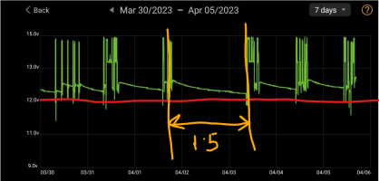

Hi @Dellmassive here are some more data images...
7 day... Loads better but not sure if it would last 3 weeks above 12v if I didn't use it?! Do you think I should put the new bigger battery in now and see how it goes? Or???
15 day plot...
its looking good for now.
staying above 12.0v
looks like the longest its been left alone is 1.5 days. ( not even a long day weekend yet)
so id say keep going as you are. . .
see how is goes over 4 days, then 7 days of no use.
all being well it should last 3-4weeks . . . . . and still restart
( though i would expect the voltage to drop slightly below 12.0 after that time)
