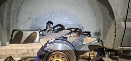

Any bodywork mods to get the this low?
As Chris @The Van Cave says nothing hefty and nothing of structural concern. Cut, file, underseal, done.
Picture below for reference left hand cut is about 40mm across. There's only 2 bits been cut the far left and 2nd from right the other 2 are how it leaves the factory.
