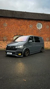

My new normal...
Low (for motorways)...
As low as it goes without catching, I can just slide the airlift manual between the tyres & the (unmodified) arch liners...
