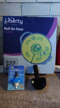

Now I have the tanks underneath, need some accessories.
The hose and filler cap are just for filling at home, works a treat.
The funnel is 3d printed from ebay. I had to cut 10mm from the length, as the filler pipe connected to the inlet is at a very acute angle because of the location. Very neat and a good quality finish, no leaks when filling from a container, so will keep this in the Towbox.

I recognise the funnel - we have a similar one for our Nexa, and the same couple also printed one for our previous motorhome. Great service!

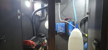

There's mine.
I have a 2 way 240v fuseboard connected to the EHU. 1 mcb does the 240v sockets in the van for when on site and the other powers the victron charger on the right. That then charges the LB which runs the 12v electrics.
