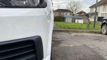

Hello, just picked up and returned my t6, so when i looked round and test drove the van it was great, when i picked up yesterday, i picked it up in the evening and finalised the payment. I noticed it was pulling to the right and thought the tracking might be off. so this morning i noticed that the left wheel arch/fender wasnt quite straight. on further inspection it looks like it took a knock on the front left and the garage tried to fix it. the plastic inner liner is slightly out of place and damaged. then i realised the trim around the light is not square either, not massively but not right. then i wiggle the left front lower bumper and there is squeaking and more movement than should be.

Photos ?
At the end of the day, I can get a new front wing and plastic arch protector for 180, just need to get it sprayed and put on. I am however assuming an impact of this size to not crook the sub frame. Inside the bonnet there is no sign of damage what’s so ever so kind of leaning towards it being cosmetic. But I am no expert and the forum advice greatly appreciated

Think i just figured out what is going on, so if you look closely at the picture of the fender, you can see some crumple on the metal work. I recon this has slightly shortened the reach of the fender to the front bumper. to make it fit they have had to push the front pumper tighter and further round than it should go and this has made all the trim come out of alignment. The squeaking sound as i move it is probably because the tension doesn't make the retaining bolt underneath line up.
This is of course total speculation but i recon this is the part fault and the cause of it all.
