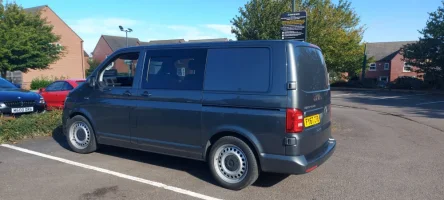

Got my T6 Caravelle 4Motion a week go, and the drive back from Birmingham to Wiltshire was absolutely fine, aswell as the few days backwards and forwards to work and back. However yesterday going round a roundabout I heard a bit of a knock from what I thought may have been the front drivers side wheel/ suspension area. I wasn’t sure what I’d heard so just carried on the few miles home. Doing a sharp, slow right turn onto our driveway I heard the nose again which I couldn’t tell if it was something catching (our driveway is a slight upwards slope). Anywho…driving to work this morning seemed fine but again on the way home I heard the knocking noise a few times, mostly going round a left hand bend when the front right wheel was under load, but also again on a very slow right turn with full lock.
