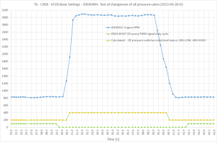

Please run "VCDS Basic Settings - IDE00494 - Test of changeover of oil pressure valve" as described in post #1 in thread below.
Looks like some old codes.
So may be worth deleting codes and see what comes back.
But oil pressure needs looking at.

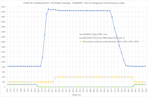

Thanks mmi,
I think I ran the test successfully... see attached
Edit - Now with correct test run.

Thanks mmi,
Thanks. So I think we couldn't confirm if the test would ever give a fail - it's quite possible the "success" is simply that test run through and user him/herself must conclude whether the result is actually pass or fail.
Anyways, below a plot of yours and for comparison with same scaling my results (from the other thread rescaled).
At first glance there seems to be quite a delay before oil pressure reaches the "HIGH" - 2.5 seconds. Measured from "green" at 0% (20.5s) to when"orange"is at 400 (23.0s)
In mine it's only 1.0 second (below).
Difficult to conclude for sure - probably would need more data recordings - e.g. engine (cold/hot) startup, driving, etc.
Anyways, possibly sticky high oil pressure sensor and/or sticky (non-responding) oil pressure regulator. The latter has been more common cause.
