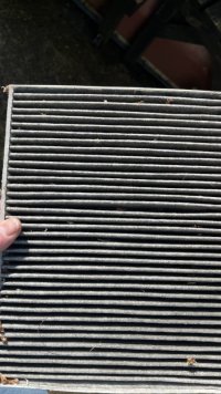

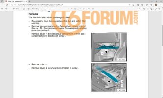

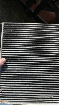

I managed to do this yesterday and fitted the carbon one. Apparently should be changed every 2 years. How to replace this is very straight forward and I did't need to remove the glove box or any upper trim as it suggested on previous posts. Remove the black lower trim, remove the 6mm screw at the end of the filter cover and depress the release catch and pull down. Take out the old filter noting the airflow arrows and replace with new and complete the process in reverse. You will need to make sure you get the tab that locates out of sight in the right place or the filter cover won't stay snug. Diagram taken from the other posts show these bits.1.JPEG2.JPEG3.JPEG4.jpg
