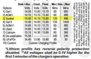

That's quite a high voltage for a standard/wet battery - what profile is the Sterling currently set to?
These are the profiles I can find in the manual - possibly with the note you may see 14.5v for the first couple of minutes?

Sort of, it would have been charged at too high a voltage. That means the battery likely was charged way before the Sterling thought it would be and may have been charged at a higher rate for a long while if it never reached the voltage to trigger the next stage.

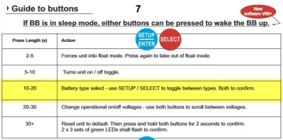

Make sure you are reading the displays on the charger correctly - the battery type indicator is a flashing one and only shows in charger startup (not engine startup) - there is a button combination in the manual to check at other times. If it's steady it's reading input voltage.

Looking at the chart above "Calcium" is a very high voltage profile - that might be the root of your issue.
From the manual this is the procedure to set the profile type - would be useful to set it to "Sealed" and see if the voltages during charging are more rational (and show the Sterling is behaving)
Thanks - changed it to sealed and it’s running at 14.35v even after 10 mins or so. I’ll run it like this for a while and see if the smell comes back and see how the battery does. I’m going to order the Fogstar drift 105 as that will easily fit in and I’ve got a few weeks to work out how to secure and also whether I need to change the charger as well in that time.
