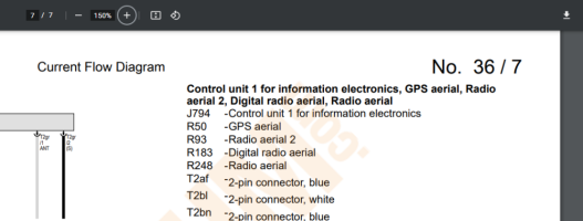

I took my mirrors off my 2022 T6.1 to get them painted and when I re fitted them I can not find were this wire plugs into. I know its an earth wire and it comes from the R/H mirror into the door but I can not remember if it plugged into anything.
If anyone can help please
Infotainment system/satellite navigation system wiring diagram including associated speakers/aerials etc VIP Membership is required to download this document
Replaced my antenna recently. The black plug (which I assume you’re referring to) was one of the two antennas - plugs into this silver metal end that should have a matching black/purple socket. How lucky that I took a reference photo before pulling it all apart.
Maybe because it is an Australian model and we don't have DAB or SOS it is not
connected.
I have looked everywhere and no other connectors for it to plug into.
Thanks
