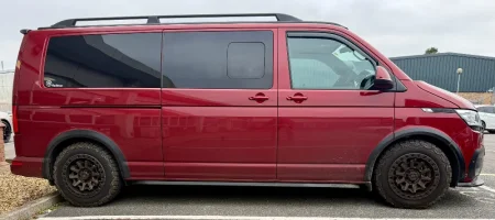

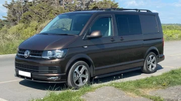

Very good points made. Beautiful colour van.These are not the wheels you’re looking for (said in an Obi Wan Kenobi voice if you choose), but I am on 30mm lowered Sportline springs and 235/65/17’s on my T32. It does measure 420mm from wheel centre to arch so appears to be more like 40mm drop though.
Anyway it looks way better than the Sportline wheels that I had fitted before with 255/45/18’s.
What you have to remember is that comparing those two tyres sees it sitting 26mm higher off the ground but also a 26mm shorter arch gap.
View attachment 306496View attachment 306497
They are a lovely wheel and im changing for similar reasons to you.By the way, I did t dislike the Sportline wheels at all, I just wanted AT tyres and just wouldn’t have worked in my opinion.

For the record it looks superb. Are those the Navis MAC AT in anthracite ?View attachment 306512
Tyres are Michelin Cross Climate 2 SUV (Load Rated). They aren’t cheap but about 26k miles on them and they are still in decent shape with plenty of life left.
Garage went as low as they could go without causing any rubbing issues. A smaller tyre would drop the height of the van further, but would likely compromise the comfort.
