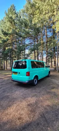

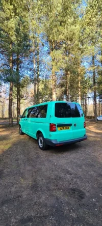

As I mentioned before I’ve gone for just mid windows, it may not be to everyone’s taste but I like the commercial look, and I do like it dark when I’m trying to sleep :) I’ve also installed a digital rear view, so rear visibility is no problem too. Here’s a couple of pics I just popped outside to take, it gives you an idea on how it looks. I think full windows all round (with a dummy blackout drivers rear, if fitting full height cabinets) or just mid windows are the two best options. I opted for an opening driver side mid, for hob ventilation. I think that’s pretty common A1B70170-9E8B-47D3-A4AB-9B219263A055.jpeg3864D0EC-0171-45E4-8929-01EB6766E9C2.jpeg
Looks great also. Yeah all down to owners preference. Either way i think the colour just works with the tints and stands out. Me and a work colleague are currently converting his white t5 from panel van to camper and im gonna get mine during this to work on both together. Its a bit hairy sawing out the roof and windows but having done them now, they look great.
