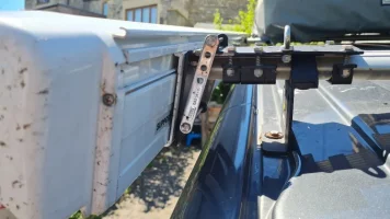

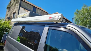

For reference, I used the Fiamma 98655-770 brackets to attach awning to the bars.
Perfect, thank you. Those were the mounts I was looking at, although it seems they only support bars up to 55mm wide, but the ultibars are 60mm, which is a massive shame as they are half the price of the Thule ones :(
Sorry, another question if you don't mind. Are your bars the 1400mm ones and how many Fiamma brackets are you using

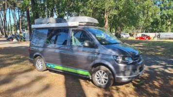

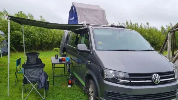

I have the VG263 bars that are 1400mm long.
The van came with 3, but I have added a 4th so that I can carry both a roof tent and a roof box.20230612_094348.webp
You can fit 2, 3 or 4 depending on what you need to carry. You just need to make sure that you get the correct height of mounting brackets , depending on which mounting points you intend to use. This ensures that all 4 are level. The front and rear are slightly taller (79mm) than the middle 2 (71mm).
I used 2x Fiamma brackets, on the front and rear bars.
