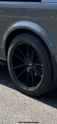

Ohhh thats nice para, what grill is that? an insert? and whats the splitter? and the wheels?
Loving it!
Picked it up today, pretty happy but knackered from the 10 hour round trip!
Velare wheels but not sure yet what model and no idea on the grill or splitter tbh

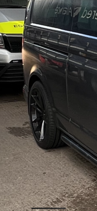

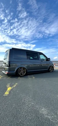

LWB Kombi on 18" Sportline wheels - i am considering moving to a 17" swamper on falken wildpeaks for a better ride quality, the previous owner said it was lowered but i cant remember to what - how can i measure that ? maybe a daft question but this is my first van and new to the game
Measure from the centre of the wheel to the middle of the arch. A std T6 is 460mm front I believe. Yours looks like it's about 60mm down at the front? Also bear in mind a 30mm lowering spring might equal more drops if the van is loaded up, a camper conversion etc.
