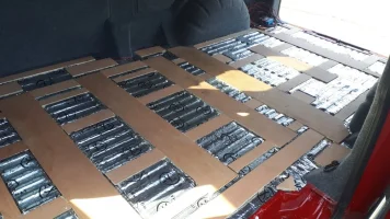

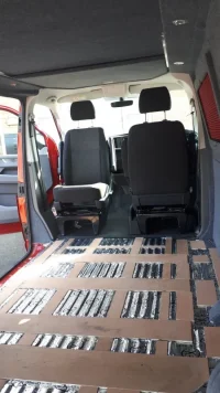

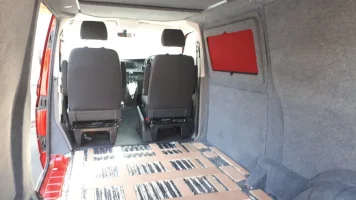

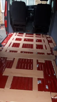

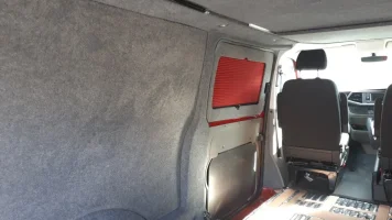

Since my last updste I have been progressing with the conversion. The best wsy to show this would be with photos so here goes..

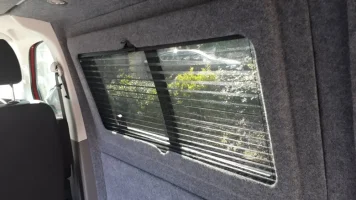

Nice work well done! Are they vanshades? what is your impression of them please?
Hi and thank you. Yes they are Vanshades. I am very very plessed with them. The blinds on thr side windows with the opening section to them have the flyscreen incorporated so that I can have the windows slid back open and the screens will keep the mozzies out. The rear window of the tailgate only has the blind as it's not an opening window. I love them but choosing your colour will have you spoilt for choice.
Following on in my conversion thread. On Fri 1st April I set off at 05.30am from Nottingham to drive to a location on the South side of Bristol. The reason for the journey was to collect a 1 piece, 12mm, birch ply floor for the van. It is essentially 1 piece however there are two very small sections added using 'biscuit' joints. These two sections sit 1) just forward of the N/S rear wheel arch and 2) just inside the tailgate again on the N/S and are both about 4" wide and 8" long. The rest of the floor is one sheet of good quality ply. A one piece ply floor for a LWB van is a bit hard to find and not cheap. The company that supplied the floor is called T-Spoke Conversions. I can't speak highly enough of the two members of staff from the workshop that lifted the floor panel into the van and practically laid it for me. For this floor to fit you need to have removed the bulkhead metalwork and grind out the spot welds. The door floors for quite a wide variety of vans. I was home by 13.00hrs that day andthe floor was bonded - not screwed into place. I hope this info helps someone in the T6 family.

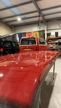

Probably about time I popped my cherry with a pic, and no better time than after the first time I have ever washed it!
Had it just over a year, it was a Kombi, and now a camper. It's been a self conversion apart from the pop top and windows.
