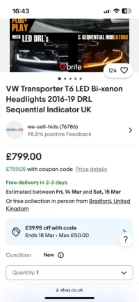

Thinking of going down the AliExpress route now…but there are so many reseller choices that I’m a bit baffled! Does anyone know if there are there actually any differences in the product?
I currently have the H4 candles and none of the options seem to suggest they are a direct replacement for these. The below eBay advert (for what looks to be the same from a British reseller) suggests an additional loom is required for replacement of H4s. They’re charging £££ for the resale though… £799 vs £460 - 600 depending on who you buy from off AliExpress.

I just opened your link to find they’re discounted at the mo.
Also, they don’t seem to mention an extra charge for the H4 loom.
