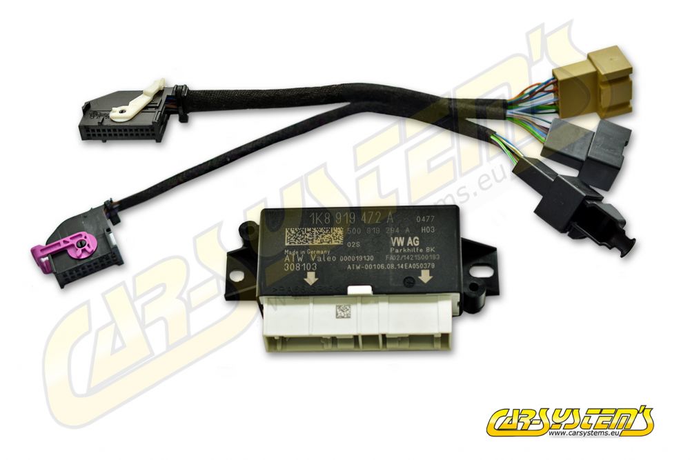

Also, am I right in saying that the new 8K module that’ll come with the front PDC kit from car systems eu, will be pre-configured so will be seen and work, straight out the box once it’s all installed? (No VCDS etc. required for the retrofitting front sensors?)

4k means 4 sensors ie rear only so you will need to change it for 8k module which is 8 sensors ie front and rear

When it comes to upgrading to the 8K Module , it’s looks like the part number needed starts with “7E0919475” , but from there, there looks to be a lot of different one some end with “T”, or “L”, or “K” or “AA”. ?
The last one seems to be the most common used in T6s. But what do the suffix letters mean and can you use any of them ?
Im not sure is the honest answer, i would assume its just different software etc
It looks like S and AA are the 8k versions
K & T = 4K
L & AA & S = 8K
looking on ETKA it shows T & AA variants under transporters
carsystems list S & AA part numbers on their upgrade kits so i would stick with them (preferably AA if available ?)
Yeah, it seems like AA is the one to focus on, i recall someone on here sell a S a while back, so thats a good sign..
Looking online there are a number of 8Ks (VW don’t make it easy)
Manufacture date on all of those apart from the AA predate the release of T6 vans and a couple say 7N0 which i think is sharan ?
Its more than possible they will work just fine but not really worth taking the chance (unless they are dirt cheap) i would stick with S or preferably AA

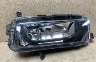

  • 7E0 941 662 A - Left Fog light (£25 - eBay)
  • 7E0 941 662 B - Right Fog light (£20 - eBay)

  • 7E0 919 475 S - 8K Park ECU (£40 - eBay)
  • 7E0 571 095 - Front Sensor & Fog light connectors harness / loom (£45 - Alibaba)
  • 3C8 941 431 A - Light Switch / Dial - (£9 - ebay)
  • 7E0 927 122 - Parking Dash Button (€25 - eucarsystems)
  • 8E0 919 279 - Front Parking Buzzer (€10 - eucarsystems)
  • xxx xxx xxx - Custom Loom for 8K Park ECM, BCM, Fog Light Switch, Dash Button from 7E0 571 095 (€75 - eucarsytems)

Front fog light retrofit..
Looking to retrofit the fog lights this weekend or next, and have two key questions
1) what screws will I need to fix them ?
2) what led bulbs / kits are recommended now - there seems to be a lot out there on the market?
Hi @Pauly - any insight you could give me on my questions above, especially no. 1 - and the screws, I want to be sure when the fog lights go in they stay fixed in place..
Haven't had fog for years so never wired ours up ....last year through france had 5 days of 'pea souper' :rolleyes:
