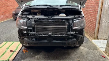

Thanks guys, I went for it and found it reasonably straightforward following your advice and guidance. Only slight stumbling block was the pulling the front from the three clip fixings at the front. It was solid. It took some scary effort to wrench it off those clips.
As said, now done once I know what’s needed.
Thanks again to all of you so much appreciated.
