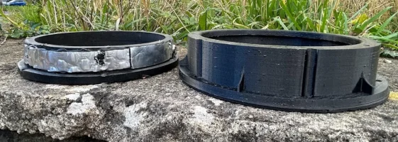

Apologies in advance to anybody I ever told that the T6 has 8" diameter door speakers.
In a shock peak behind the curtain that is the door card it turns out there is indeed an 8" hole in the metal tray that carries the window channels and gubbins with a plastic reducer fitted to hold, on my T6, a measly 6" speaker.
Is this what normally passes for a supposed 8" speaker on the T6 or was my 2017 Trend line originally specced with electric mirrors, A/C, front assist and ickle 6" door speakers?
I figure I'm going 8" but going to have to cobble up some plywood rings to allow for not using the VW plastic speaker reducer/holder.
Oh and the reason that original speaker was barely working was down to a water based partial detachment of the pole magnet where the glue holding metal to metal had died allowing the magnet to move a fraction and the pole had fouled on the voice coil former closing the gap to jam the cone.
I'm less bothered about the speaker having failed than I am at blindly accepting the premise that this is an 8" door speakers.

I wasn't going to try and go all Steve Meade with the camper but now I'm stuck with the passenger door card off and knowing that I've got to wait for some actual 8" drivers and "fit" them before I can finish both doors and that part of my sound deadening exercise or I end up locking myself in the van with no door controls.:whistle:
That's my RE MX 18 sub, 4" voice coil, roughly 3" xmax and surprisingly light due to the underhung motors neodymium magnet.
These were on the old rings. You can still see some water marks but the wood rings were knackered due to the water moisture in the door.
