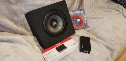

well no we have the answers . . . . . . This is what you get:
We get:
8" JBL Stage 810 Sub in a MDF sealed box.
A Vibe PowerBox 400.1M Sub Amp Micro Class D Mono Block
A Generic Amp Cable set based on 10mm2

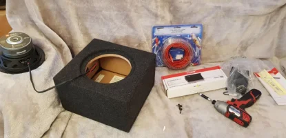

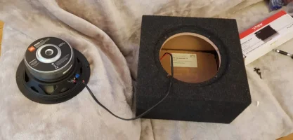

So whats the first thing to do . . . . ? -- Take it apart -- =]
JBL Sub:
here we have the Box, Its a shame there is no speaker gasket tape or Polly Fill/Acoustic wadding in the box, but that can bee added later.

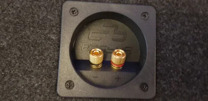

The Box is MDF and looks well built with glued edges . . . .
with a terminal plate on the side.

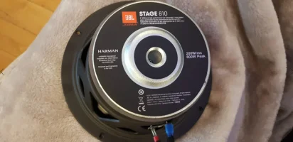

this is the speaker . . . . .
its a JBL STAGE 810,
with 200W rms and 800W Peak 4ohm - so looks fairly well matted to the Vibe amp.
Product highlights:
The Amp looks like this:
it comes with a small remote boost control via the RJ11 lead . . .
one interesting thing to note is that if you use HI-Level inputs then you done need a remote turn on - and it will auto generate a +12v remote output - which is nice =]
If you feed it with LOW-Level RCA`s as an input then you need to supply a Remote turn on feed.

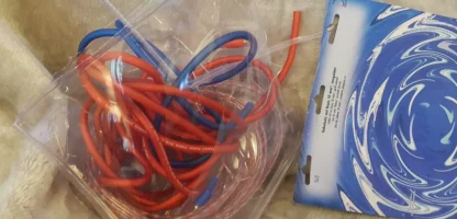

The cable kit is Generic and non descriptive. . . . .

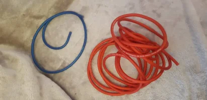

you get some power cable,
and a bit of ground cable.

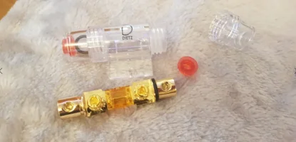

a 40A midi fuse + holder

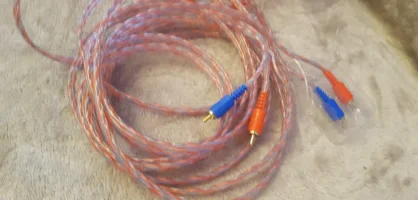

some RCA`s
and a few connectors..
You dont get any speaker cable . . . which is odd?
Its all very cheap, but will serve the purpose . . . ill be swapping most of it out.
