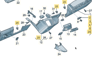

Under normal use the twin USB C sockets on my T6.1 startling have pushed through into the cup holder/ USB c / 12v socket trim panel.
Any ideas on how this panel is removed before I snap something? I've searched forums and YouTube but with no luck!
Alex
I suspect it levers up with a trim tool, I expect there is a section in a manual in the downloads area, I'll have a quick look.
That's great thanks! I missed your last very helpful reply. I've just been out and prised it up. Cup holder clips out if you lever it in the right places. I just used a small screw driver which caused some very minor scuffs which I can live with. Picture below to show locations of clips.
