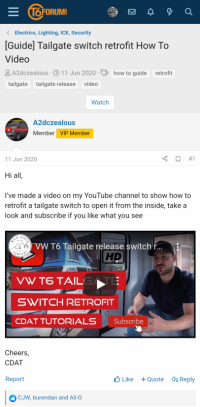

@Ann - Check out the attached video and read the thread. Maybe this whst you want?

I did it like @BoroBoy.
I realised it could be dangerous with no exit at the back. The converters obviously didn’t want the job because they quoted me £180 to fit. Sod that! So did it myself in a couple of hours. Once the tailgate card is removed it’s fairly simple to splice into the actuator wiring. Now one press and the latch is released Then I put a momentary switch on the card and I’ve marked what the little button does, just in case we have a galley fire. Whole job cost me £2.65. :whistle:
