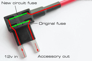

For preference if you put the fuse tap in the "empty" slots it should work as there should be a common +12v bus bar (you should see that the metal contact is there like in the picture)
So long as you put the fuse tap in the right way around and the fuse in the right position it'll work fine and you're not disturbing an existing circuit.

Interested can you explain a little more on the fuse tap the right way around comment pls
Plus the fuse in the right position thanks
