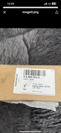

Same issue . Full heat The servo motor control arm has snapped. This is the part VW sell as they know of the issue!!
