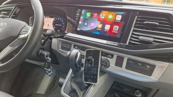

iPhone and van linked instantly. Of course, then you've got the issue of where do you put the phone whilst driving, because it seems the CarPlay only works when tethered and there's nowhere on my dash (T6.1) to put it securely without buying another plastic holder . . .
I could only get carplay to work reliably with a genuine apple lead. I’ve run the cable into the glove box to get the phone out of sight. I’ll post a pic later.

My 6.1 worked using a usb-c cable. And I’ve just plugged in a carlinkit module which connects phone to Apple CarPlay wireless. Really impressed and it’s quite small. Cost £56, so not too bad. I’ve got the small screen with out Nav. But now I’ve got google maps via CarPlay and it auto connects to my phone.
