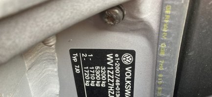

I’ve recently bought a T6 Kombi, and been doing some servicing/maintenance, and it’s raised a couple of questions. I fitted new discs and pads on the back, parts supplied by my usual supplier were spot on, however, when I went to change the front pads (discs look to be pretty new) the new ones were way too small. When I measured up, the discs were 340mm and it has twin pot calipers. Also, the struts have the twin bolts where they attach to the hubs, all point to T32 spec ?
My V5 tells me it’s a T30 H-LN, but the revenue weight is 3200KG, and the VIN sticker also confirms 3200KG too !

My V5 says T30 but GVW of 3200. Van plated as such too.
VW themselves have it down as a T30 LWB trendline. It's a T32 SWB highline :slow rofl:
