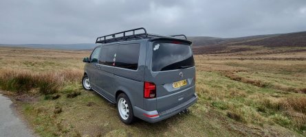

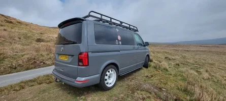

For what it’s worth my van is fitted with 17” Black Rhino wheels 8” with a ET35 and 235/65/17 AT tyres no spacers. It’s a full camper conversion and is mildly lowered iirc 35-40mm on springs and all is good no rubbing so far . The previous 20” wheels rubbed at full lock mildly but were 9” wide. Happy with the set up we have now certainly comfortable.
Lovely looking van. Thank you for the info. It’s all helpful.
