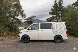

I think I going for kmc heist with falken wildpeak tyres from vwt5upgrades I did a google gemini makeup on my van

I run 235/65/17 Wildpeak’s on my Black Davenport’s. Mine is on Sportline springs on standard T32 shocks, so technically 30mm drop but measures more like 40mm.
Mine did have a minor rub on extreme full lock when turning on an incline. I put it down to the higher offset of these wheels compared to the aftermarket options. Added 21mm and 25mm spacers and no more rub from the front.
I reckon I could get away with a further 20mm drop easily without further issue.
