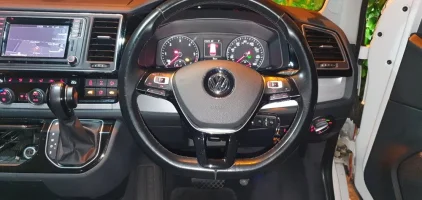

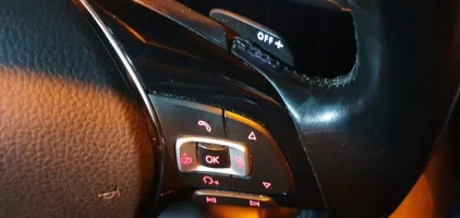

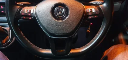

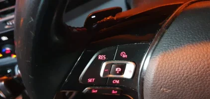

Hi guys. Just want to show off with my MFSW retrofit ;)

Smart looking wheel you have there @Insert Coin :thumbsup:
I notice the airbag clips are different to what i have on mine. I have two metal hooks that the bag clips too. I have not seen one like that before, what is it off ?
Arghhhh it don't f***ing fit!
Mine's the same @StudleyGlass the Passat is totally different.
