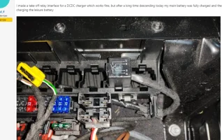

I made a take off relay interface for a DCDC charger which works fine, but after a long time descending today my main battery was fully charged and then the DCDC charger stopped charging the leisure battery

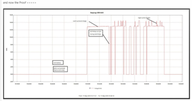

these charts show that the OEM setup keep the charging relay connected all the time while the engine is running . . .

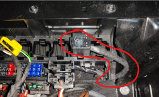

and looking at that pic you have above, you have a quick fit Relay kit wired in . . . . that should be using the same OEM trigger.
i would start by checking all your connections are good and tight and no fuses are melted or damaged,
including the grounds etc.
This is what I expected having read several threads, however as it is a Euro6D emissions level perhaps it has changed as they are constantly improving

The pic above has the additional OEM fuse holder I added, so I could fuse both sides of the DCDC charger - both of these are fine.

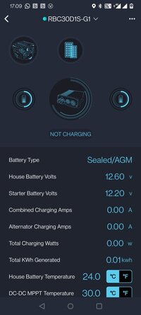

Here is today's log. I put the relay back in after the first spike when I saw it was no longer charging the leisure battery. We were driving on and off with multiple stops between 3pm and 8pm. I don't have a log of the starter battery, will probably buy another BM2 for that as they are really nice and the app works well (thanks for the tip @Dellmassive )
Battery defo looks low SOC.

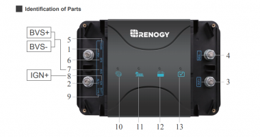

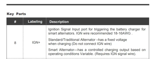

I solved the problem, the Renogy manual was incorrect (or my one is faulty). Only one of the ports of the ignition sense actually works. Swapped it over and it is now fine.
Renogy had a typo in the early install guide.
they also come with a 2core cable . . . and green block.
this has been upgraded to a single red wire pre wired into the green block.
