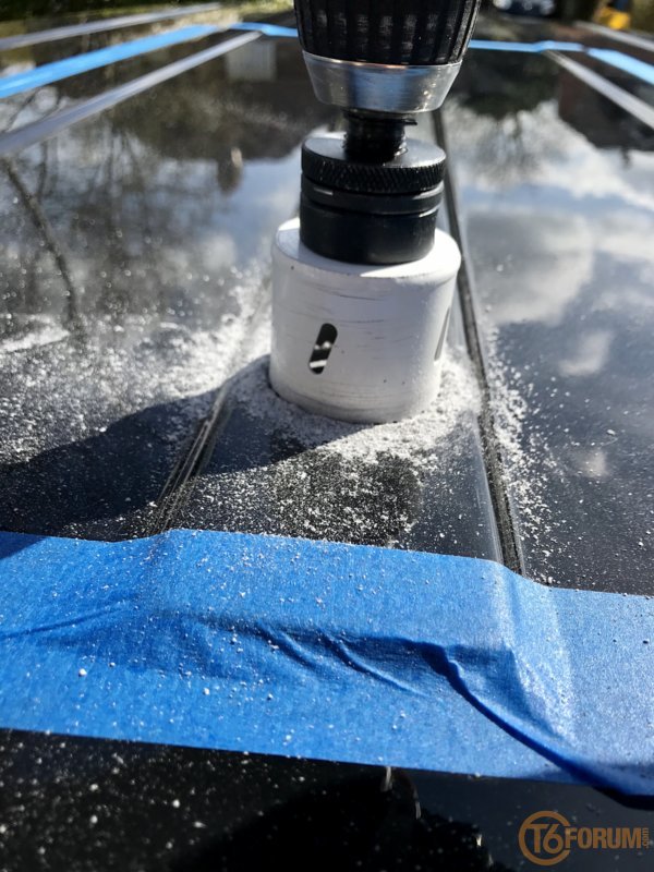

I drilled the hole in the roof for the junction box. Then taped around the edges of the panel, with the sides having two rows of tape. The inner raised ribs had tape applied across the way rather fore and aft. Panel location was marked with masking tape. 4 baked bean tins were used to hold the panel a few inches above the roof. This gave enough space to apply the sikaflex then removed the back paper from the Sanoj tape. When everything was ready to put in place, I removed the two rear tins. This allows adjustment when positioning the back of the panel, but keeps the front aloft so that the whole thing doesnt stick down. Once it's down, it's down. When I was happy the back was squarely lined up, took the front tins out. Viola, beans on toast.

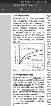

Just a word on curing time for 521. Note from the graph that it's dependent on temperature and bead thickness, along with exposure to moisture. I was confident the Sanoj tape was more than adequate to hold the panel firm, while the Sikaflex cured. However as a precaution, I kept my speed to a maximum of 50 mph just for the following week after fitting.
