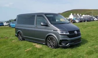

So picked up my van today after having a SkyLow fitted which was installed by the team at XtremeVans.
I have to say initial impressions are that it's an excellent product. I love the way it looks, you can barely tell it has a pop-top fitted until you are up close. No loss of internal headroom, you actually gain a little bit (maybe 5-10mm) on the inside. It's my first pop-top but it's very easy to put up and pull down, and uses the same locking mechanism at the front from the Aurora. The guys at Xtreme did a great job with the installation as well, and managed to relocate my existing lights to the sides and added a light on a separate switch up in the pop-top itself. No squeaks or creaks on the journey home, and no noticeable additional wind noise at motorway speeds either.
Overall very happy with the results, couple of pictures for anyone that's interested. Happy to share more details for those considering the SkyLow.
