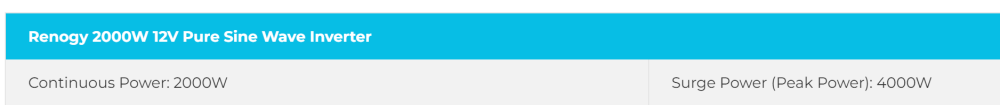

I think these are still available! You'll be needing a 2000 watt pure sine wave inverter too. It's only money, they say!
In reality you would probably need a 2500-3000W inverter to account for the inrush current when starting up. Same as a microwave.
Although mine is happy at the full 2000 watts on a 2000 watt inverter... I know this from my wife's kettle boiling skills...
Most inverters will have a surge current rating that'll more than cover that. My Renogy 2000w is rated for 4000w surge.
Your inverter may be rated at 2000W continuous with a higher momentary rating, which would allow for startup/inrush current.
