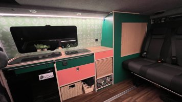

Nice interior!
What bed’s that? The Riemo 3000?
Nice interior!
Thanks, yes, it’s Reimo 3000. I built the units to fit up to the bed. At the base of the units you can see the basket that pulls out. We take that into the house, load it with snacks or whatever, and then load it to the van.
