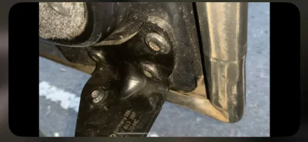

Been doing some investigation and it seems when I pour water on the rear quarter, it flows down and goes straight into and behind the sliding door channel. It then flows toward the start of the channel and then pours down into the bottom slide door roller area then collects in the bottom runner area. 20221024_153611.jpg20221024_153633.jpg
Been doing some investigation and it seems when I pour water on the rear quarter, it flows down and goes straight into and behind the sliding door channel. It then flows toward the start of the channel and then pours down into the bottom slide door roller area then collects in the bottom runner area. View attachment 176925
I’ve just posted similar elsewhere. I’ve recently had premature failure / disintegration of roller because of this. I think the bottom seal on the door (see photo above) shouldn’t be there- it’s blocking drainage and holding water. If you look at the cab door seals these stop at bottom, slowing water to drain out. Thoughts?
