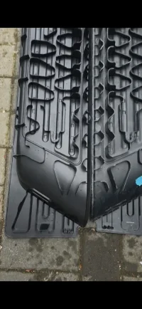

Recently purchased a kombi side step with light and just looking to see if this bow in the middle is normal? The original non deep step is flat as a pancake even when not fitted. This seems to have a bow in the middle and will not sit flush in the center. I haven't been able to fit it correctly with the clips yet as the light & loom never arrived along with it and still waiting for them to send it out

mine was like this as well. i got a heat gun and got it as warm as i dared without melting it, then held it flat until it cooled which seems to have worked

Probably from being pulled out of the mould while still hot.
This is how the replacement fits, can't physically fit the base poppers as the step is physically too wide to fit. It runs around 20mm longer than oem and the two outer plastic fixings thay slot into the gap either side of the door sits about 10mm wider than oem. The company are now ignoring me dispute sending videos and images. Alrrady had to chop of the rear threshold as this also didnt fit
