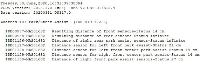

I mean the revision A of the PDC - 1K8 919 472 A
Just asking as I'm a bit challenged with same fault as @hanzz using revision 1K8 919 472 C. Fortunately it seems not to affect the operation but just can't sleep at night
Could you please share the current scan of the module 10?
Meanwhile...

1K8 919 472 C, well - the colours... and slightly different distance thresholds...
EDIT:
Later realized that the distance bars are "grayed out" when van can't move e.g. Park is engaged, although true only on "main" display. Also the warning tone turns off when gear in Park.1K8 919 472 C, well - the colours... and slightly different distance thresholds...
