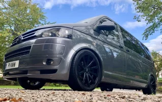

Fully sound deadened, T6 Tailgate plus LED tail lights, 19" Amaroks, Bilstein and 50mm Eibach all round, Some audio, RLS plus HBA retrofit, Depo xenon reps with LEDs, FBMFSW.... Probably forgotten a few things
