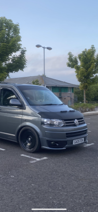

Any chance of those wheel and tyre details? Awesome and need a look like that
And the seats!Any chance of those wheel and tyre details? Awesome and need a look like that
Wheels are AXE EX15 10.5j rear and 9j front. Run 275/35/20 tyres all round and 10mm spacers on rear and sliding doors clear perfectlyAny chance of those wheel and tyre details? Awesome and need a look like that
Seats were custom trimmed and heated by my local trimmer, not a cheap job but the finish is unreal… as hopefully you agree. Well worth it in my opinion.And the seats!
Yep mint mateSeats were custom trimmed and heated by my local trimmer, not a cheap job but the finish is unreal… as hopefully you agree. Well worth it in my opinion.
Once you're on air, you're gonna need a shorter ladder!!
