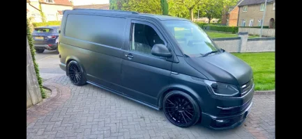

Hi I’ve never used 275/40 but I’ve heard from others on here’s they do rub.
I run 10” all round about 90mm dropped et45 fronts with 255/35 rears are et38 275/35/20’s. I’ve ran 245/45/20’s on 8.5 same drop and they rubbed on full lock. I just never used to use full lock.
Harsh ride at the front.
