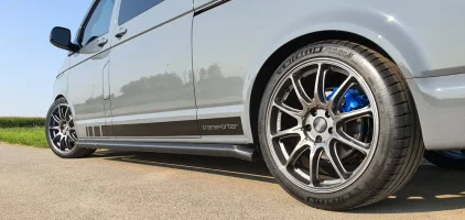

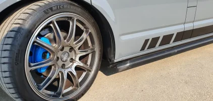

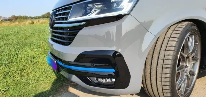

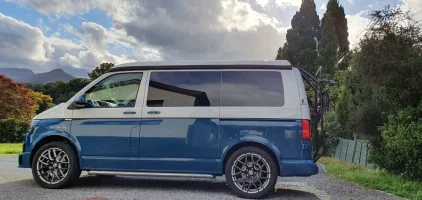

Nice is the van at standard height?here are mine, RR vogue wheels rated at 850kg with 265/40 tyres

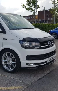

Here are mine 20” Range Rover diamond cutHello I want to put some 20s on my Induim grey T6 but can't find any I really like. Please post a pic of your van with your wheels on and the details on them would be great to. Preferably load rated

Yes standard height for a caravelle, which I have been told is different to a transporter.Nice is the van at standard height?

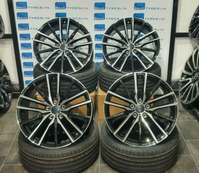

VW TRANSPORTER T5 T6 20'' INCH NEW ALLOY WHEELS WITH 275/40/20 NEW TYRES | eBay
VW TRANSPORTER T5 T6 20" ALLOY WHEELS NEW WITH 275/40/20 NEW TYRES SET FO FOUR. VW T5 T6 TRANSPORTER (Fitting kit will be required). - Tyre Sizes: 275/40/20 XL BUDGET. - 9J x 20" - ET 40 (OFFSET).www.ebay.co.uk
Thoughts please
Ffs the only wheels I really liked, tyre size can be changed but I have a T30. The search goes onThose wheels are only load rated for T28, so as long as you aren’t T30 or T32 they’ll be fine. Also, I don’t like 275/40 tyres, they’re too big really. That size tyre will make your speedo under read and you’ll be speeding without knowing it.
Actually, hold on, I may have that wrong, you might be OK for T30. Look under your bonnet, left hand side back towards the windscreen. You'll find a label with your axle weights, it'll have 4 numbers on. Top is total laden weight, next is front axle weight, next is rear axle weight, bottom is maximum train weight. You need to check 2 and 3, if they are each less than 1630kg you will be OK.Ffs the only wheels I really liked, tyre size can be changed but I have a T30. The search goes on
