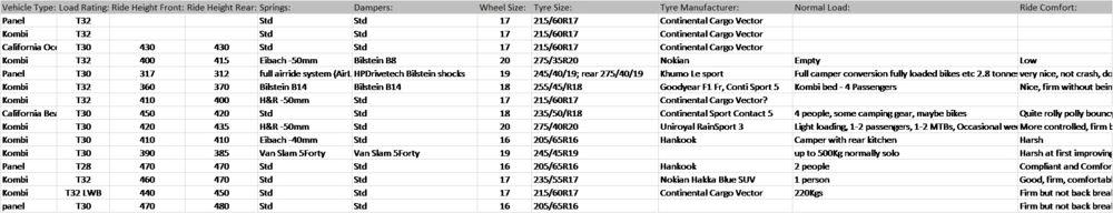

Here's this weeks scores on the doors, thanks for all the input.
What stands out is the range of the T6 suspension, if you can get the right springs (or air) and dampers, then it can perform a full 6 inches lower than the standard set up!
Keep them coming!!!!
