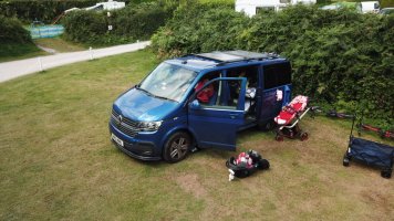

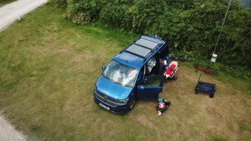

I also was afraid of losing a panel, not so much as the cost of replacing but the fear of it going through the vehicle behind me.
I have bolted mine to some roof bars so hopefully not going anywhere soon.
Not very detailed photos but hopefully you get what I have done
