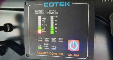

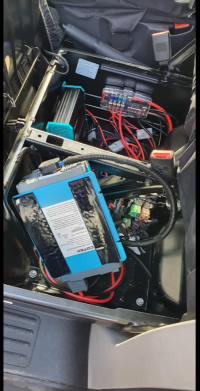

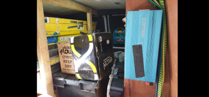

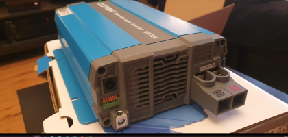

the other inverters i have that are worth looking into are:
All @Dellmassive tested and approved.
Victron 375w, 800w, 1200w
COTEK 250w, 700w, 1000w, 1500w
Renogy 100w,2000w
