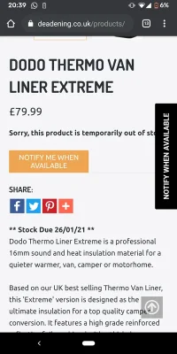

Will get some this weekend and start prepping. Can't buy the new liner until end of next week when deadening.com get more dodo thermo liner in!
Rubbish... Keep pushing the date back. Any good alternatives? Planning on using for snowboarding trips to alps so looking for good thermal properties.Screenshot_20210117-203957.png
