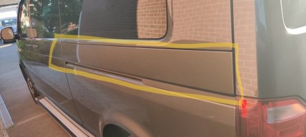

Front fixing bolts by sliding door. Need to remove rear light assembly to get access to fixing bolt at rear of the panel. Then just a firm straight quick pull as the side of the panel is fixed with plastic clips (see picture, clip diameter 20mm). Unfortunately most of them will break when panel is removed, so better have new ones available before even starting the job. Be careful not to scratch paint at top of the panel + side of the van when removing.anyone that can describe how to remove panel AS shown in picture?
Appreciated!
@Craig87 did you find some in the end?Thread resurrection!! Anyone know where I can get the plastic clips and part number?
I do indeed mate - how many do you have?I got some ads if you need any
Cheers mate. If you can’t find them or don’t get time to look, I’ll order some from TPS locally because I’ve put the trim back on for the minute and the sliding door catches ever so slightlyWill need to look but half a dozen at a guess, pretty sure I had enough to do one side
Thanks for that, much appreciated. I’ll but them.I found the Black ones advertised as being for the T5 did not work on the T6, the white ones were OK though.
